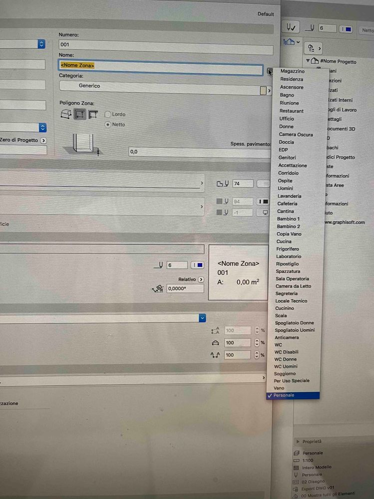

Is the default "Zone Name" list for the Zone Stamp editable? I'm not referring to the final "Personal" entry. Thanks.

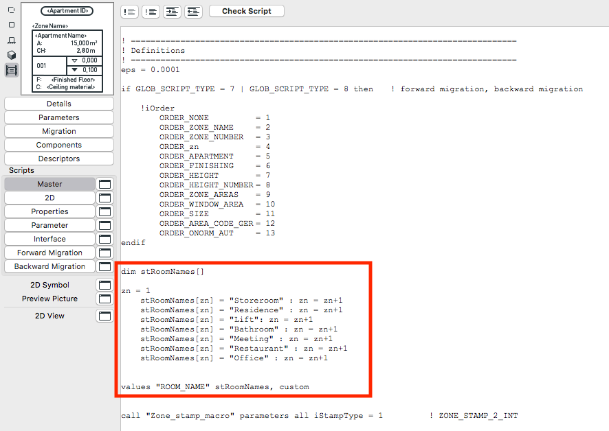

There's no need to make a copy of the macro!
You can make the modification directly in a copy of the Stamp object that you save in your personal library.
Just add these few lines before the macro call, like this.
And you simply need to add the stRoomNames[zn] lines as many times as necessary.
dim stRoomNames[]
zn = 1
	stRoomNames[zn] = "Storeroom" : zn = zn+1
	stRoomNames[zn] = "Residence" : zn = zn+1
	stRoomNames[zn] = "Lift": zn = zn+1
	stRoomNames[zn] = "Bathroom" : zn = zn+1
	stRoomNames[zn] = "Meeting" : zn = zn+1
	stRoomNames[zn] = "Restaurant" : zn = zn+1
	stRoomNames[zn] = "Office" : zn = zn+1
values "ROOM_NAME" stRoomNames, custom
