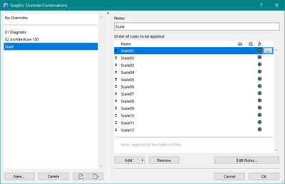

How did you group the levels to apply the override rule? I'm just curious, I would do it by layers.
Kotetsu
Hello @Rubia Torres

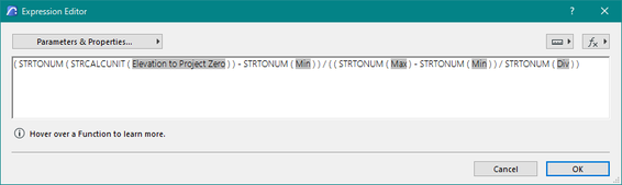

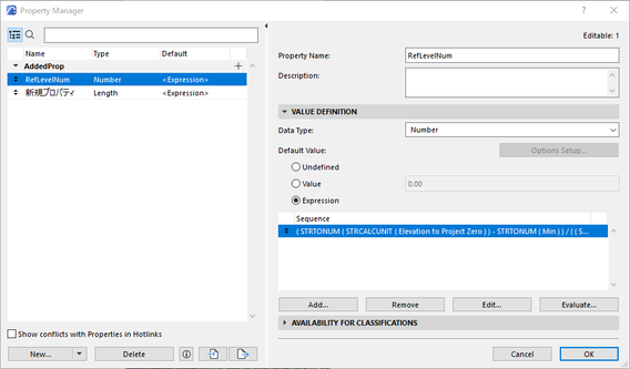

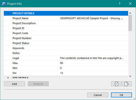

This Override uses "ProjectInfo", "PropertyManager" and "Override".
The respective colour is set by "elevation to project zero".
Changing the "Max" and "Min" parameters in the "Project Info" will change the colour range.
Please enlarge this image for more information.😁

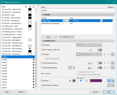

Wow! that is awesome! It seems that the project info is quite powerful. I am trying to replicate it: how did you do the GO: scale 1 < 1, scale 2<2 and so on?

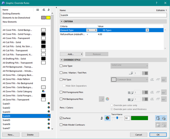

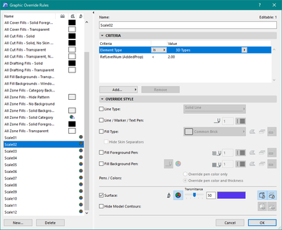

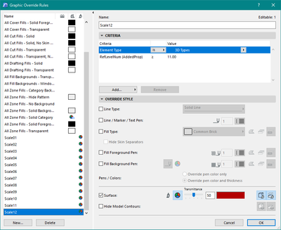

Override is as follows.
3 to 11 are identical except for colour.
Graphic Override is the first match, so it is applied from the top down.
Was that helpful to you?😎

Hey @Kotetsu thanks for the effort but I am consused and also I am bit thick for this things ... Besides that I cannot see the images properly. It seems that the web reduces quality:
From what you said  I understand the following but I cannot see the logic and it does not work haha:
Scale 01: RefLevelNum ≤ 1.00
Scale 02: RefLevelNum ≤ 2.00
Scale 03: RefLevelNum ≥ 3.00
Scale 04: RefLevelNum ≥ 4.00
Scale 05: RefLevelNum ≥ 5.00
Scale 06: RefLevelNum ≥ 6.00
Scale 07: RefLevelNum ≥ 7.00
Scale 08: RefLevelNum ≥ 8.00
Scale 09: RefLevelNum ≥ 9.00
Scale 10: RefLevelNum ≥ 10.00
Scale 11: RefLevelNum ≥ 11.00
Scale 12: RefLevelNum ≥ 12.00
What am I doing wrong? haha I am trying to understand the principle so, at the beginning, I though that if I do every scale GO ≤ of 1, 2, 3 etc it should work but it does not

Kotetsu
@ape2000
That is certainly true.(...Why can't I post a high-quality image ?🤔)
As you say, if you do that, you can do it.
Scale 01: RefLevelNum < 1.00
Scale 02: RefLevelNum < 2.00
Scale 03: RefLevelNum < 3.00
Scale 04: RefLevelNum < 4.00
Scale 05: RefLevelNum < 5.00
Scale 06: RefLevelNum < 6.00
Scale 07: RefLevelNum < 7.00
Scale 08: RefLevelNum < 8.00
Scale 09: RefLevelNum < 9.00
Scale 10: RefLevelNum < 10.00
Scale 11: RefLevelNum < 11.00
Scale 12: RefLevelNum  11.00
GO Combination is simply set up in order from the top.
If it doesn't work, something is wrong or...I am mistaken.
