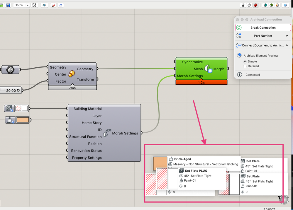

Archicad Morph Materials selections staying on screen until close of Grasshopper
See screenshot. As you can see in the red box, the materials are remaining on screen, and dont go away, and cannot be moved. Any help would be appreciated! 🙂

The picture should disapear when you have selected the Building Material. This could be a Video Card issue. Have you checked if the better Radeon Pro is in use?

Yes, the Radeon is in use because the computer is/was docked at that time. I've tried to set the graphics card switching off, so I'll see if that does anything. I don't think it will because the computer is always docked anyway, but I'll get back to you!
