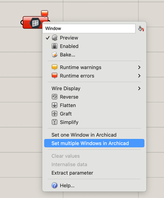

Hi, when I'm using parameter tools, for example windows
is there a way to automatically select all the windows in the project instead of having to click on all of them?
pleasse help its so annoying having to select them like that

I just tried it and it works: select all the Windows in Archicad, then invoke the "Set multiple Windows in Archicad" command in Grasshopper. All selected Windows will be set and stored in the Grasshopper component. So, you do not have to select them one by one.

What happens if you select all Windows in Archicad first, and then invoke the "Set multiple Windows in Archicad" command in Grasshopper?

Thank you so much!!! it will make my work so much easier
