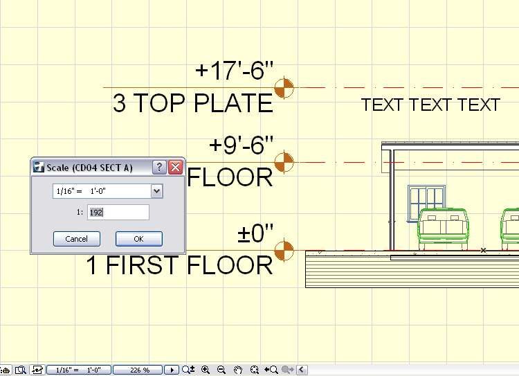

I just tried it, and I have the same "problem". However, it seems the views maintain the correct scales that I set. It is just the display of the scale in the lower left hand corner that remains unchanged. If you click it though, it shows that the scale is correct in the pop up window. I think this must be a small bug that doesn't affect the actual work.

I did look at text to verify that the scale was indeed changing, but did it again here. If you click the scale button in the lower left hand corner, do you get a different scale (showing the correct scale) in the pop up window like I do?
