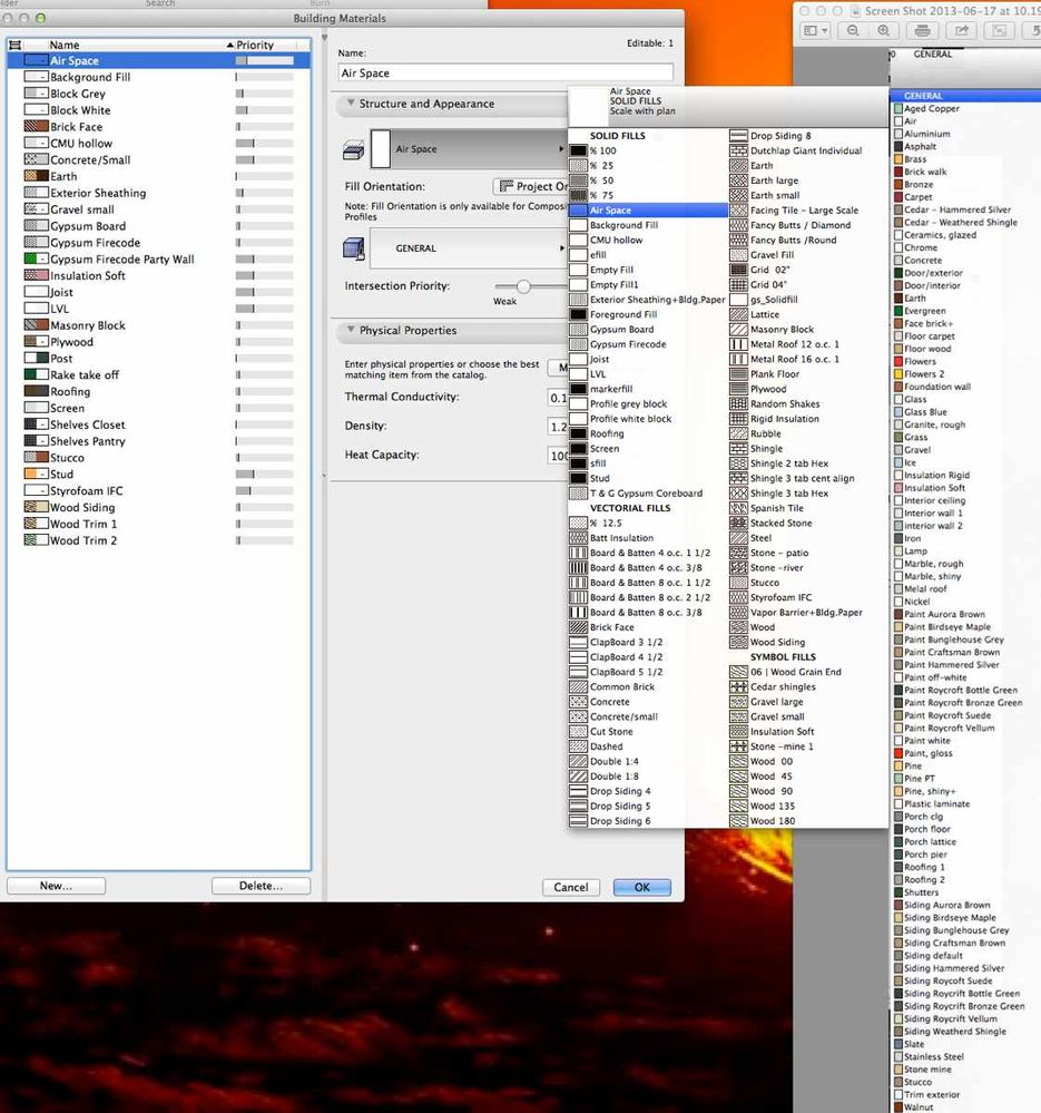

Remember all your favorites need to be carefully examined for consistency. Before walls and slabs (etc) could use fill overrides, but not now, so any Favorite with overrides will generate a unique BM. Same with any default setting, and any placed walls/slab etc. I spent a lot of time first thoroughly rebuilding all my composites and Complex Profiles, along with renaming Surfaces and fills so I could tell where things were coming from. Consistency is the main thing. All drywall should have the same exact fill, pen, priority etc or opening in a new file will create way more building materials than you expect. I had become sloppy over time so I had a mess to clean up.
The delete/replace is worth the price of the update alone. It will quickly eliminate near duplicates. Attribute Manage is something I use daily. Be aware of what will produce unwanted BM's, such as the "stock" Complex Profiles. When I migrate a file I first open AM, and purge somethings (like Complex Profile) and override everything.. well.. composites, fills, surfaces and CP's.
A clean template is very important to migrate existing files. It is worth a complete cleaning and reworking for absolute consistency of fills, surfaces and priorities. Then use delete/replace to clean the migrated file. So, the Template is worth a lot of attention first.
I changed most fills that were generic ~ "50%" as an example ~ to an identifiable name. So, I duplicated and renamed Surfaces and fills to make that work as needed. Again, I had gotten pretty sloppy, so maybe you want have as big as mess:)

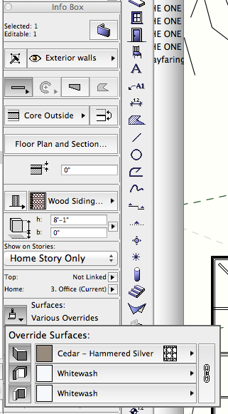

You really shouldn't need different BM's for colors as you can override the surface as before. I did not start over with my template and it is just fine, so you might want to convert first and see where you are. The "delete and replace" feature is a life saver and makes this process pretty fast. You can easily open Attribute Manager and purge unused first, should that help.

Ok, make sense. Though if you override the surface, you lose the ability to see different surfaces on a cut element in 3D, correct?
On another note, I see that through the complex profiler, you can still assign different surfaces to any side of a fill.
Steven,
Surface Overrides have no effect on the cut surfaces of elements in 3D. They continue to display as the cut surface based on their Building Material setting.
Surface Overrides affect only the outermost surface of an element. So for example, in case of a Composite, even if you overrode all surfaces, surfaces of inside skins will still display with their surfaces coming from their Building Material definition. You can play around with the various Partial Structure Display options to see that.
has anyone else noticed that Delete + Replace is NOT an option in Attribute Manager? What a pain in the butt... Being able to select 50 fill types and hit delete+replace would be so much nicer than having to do it individually in the fill types dialog, which seems to be the only way to do it.
How does stuff like this slip through the cracks? Or am I missing something?
Yes, I notice, now that you say it.
Make a wish, it would be a great addition to the program.
