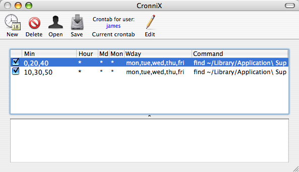

Cutting to the chase, and pardon the jargon, you're going to add two lines to your crontab:
0,20,40	*	*	*	mon,tue,wed,thu,fri	find ~/Library/Application\ Support/Graphisoft -name "ArchiCAD\ AutoSave\ Folder*" -exec cp -R -f '{}' ~/Documents/ACTempBackup/Backup1 \;
That saves on the hour, and at 20 and 40 minutes past. This saves to the other folder at 10, 30, and 50 minutes past:
10,30,50	*	*	*	mon,tue,wed,thu,fri	find ~/Library/Application\ Support/Graphisoft -name "ArchiCAD\ AutoSave\ Folder*" -exec cp -R -f '{}' ~/Documents/ACTempBackup/Backup2 \;
The command assumes a folder in Documents called 'ACTempBackup', and within that, folders called 'Backup1' and 'Backup2'. You could adjust the interval or paths as you like.
The 'crontab' is a hidden resource where the schedule is recorded. The most user-friendly way of editing it is the OS X application CronniX. See image.
Cronnix is freeware, but if you find it works for you, consider donating to the developers.

Cronnix tip: Use the Expert tab to set the schedule. An asterisk means 'every', so the task will run at the indicated minutes on every hour.
