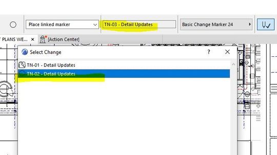

There seems to be an issue with the change manager tool preview showing deleted changes
For example, in the below image, TN-03 Detail Updates was a change that I had created, then deleted, as a test.
When I use the Change tool, and then select change, I cannot TN-03 Detail Updates in the list (since I deleted it). Yet it still shows in the little previous box on the top tool bar
You should be able to recreate this quite easily but opening change manager > creating a few new changes, then deleting them immediately. Activate the change tool, use "Create new change" and see those deleted changes appear in the preview box next to it
Is this a known bug?

I have been able to recreate it with multiple brand new files
Steps
1. open change manager
2. create a change
3. delete said change
4. activate change tool
5. it will list the deleted change in the grey box in the toolbar even though it is deleted
see attached. not a huge issue, just something weird

Yes it happened to me too - "0" got added to the deleted change.

I see. So this is not the deleted change, but a new change with incremental number added to its ID.
Each change must have a different ID, therefore this number is added and increase automatically when a new one is created. In this case, the Change tool takes the name and the ID of the previously created change (test - test) to create a new one (test0 - test). This is not the deleted change.

I see, so even if you delete a change, you can no longer use the same ID and name?
and how come when I delete a change it still appears in that grey box in the top tool bar?

1. If you delete a change, you will be able to use its ID again. What was shown in the box is the next ID number, that will be used to create the next change.
2. As I mentioned previously, the grey box did not show the deleted change. The one got deleted is "test - test". The box show the new ID if you place a new change on the plan, which is "test0 - test". The Change tool takes the format of the previously created change, which is:
- ID: test
- name: test
to create a new change with
- ID: test0
- name: test
I hope this makes sense to you!
