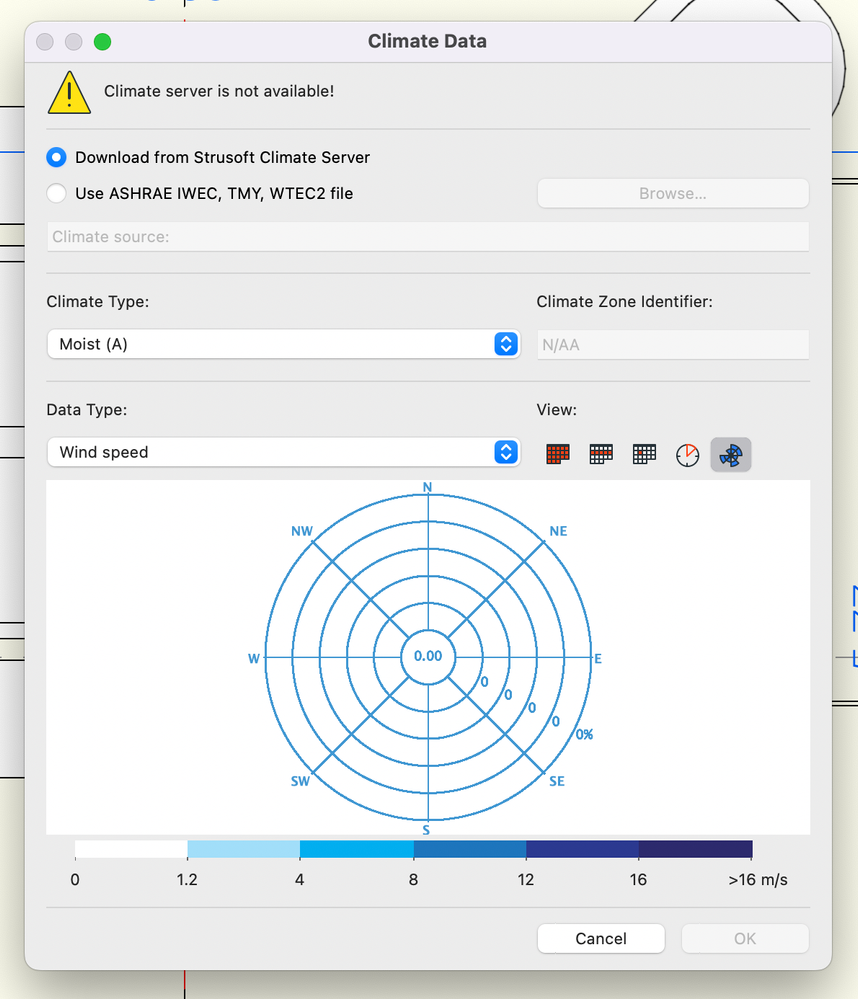

Hi! I've been trying to access the server of Strusoft from AC26 and AC25 to download the local data of Lisbon, but the climate data window prompts the following message (this message appears on the other computers of the office too):
Does anyone know how what might be happening? Thanks!

Hi @Florian1961 and @Ian_Forbes_Architect,
Thank you for the feedback.
I asked my colleague to check it on Apple Silicon earlier today, and the workaround worked for him. I also tested it on macOS Intel and Windows prior to posting the solution.
Could you please send a screenshot of the open .plist file (make sure it's the Archicad version you're using) with the server address selected? See an example.
Edit: pasted the image into the reply directly 🙂

Dear Oleksandra,
My sincere apologies. I checked and I realized my mistake. While I was using the ArchiCAD26-ARM version I edited the Archicad26 prefs file. Once I edited the ARM prefs file everything is now working. Shame on me and thank you for your patience and thorough explanations.

Dear @Oleksandra Vakariuk ,
Thank you very much for taking the time to help us with this issue.
Finally, the climate data is working.
(I did miss the "/" symbol at the end of the address.)
