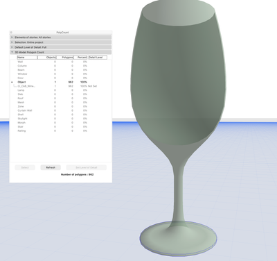

Digging through the "prokit", stumbled across this gem. Its a ±1,000 poly wine glass. Maybe you need 6-8 for a place setting in a rendered view for a client presentation. this sounds great. maybe you are working on a restaurant project, and you need 200 of these (yeah, there are better solutions), so now you find yourself with 200,000 polygons in wine glasses.
So I'm not posting to dig on this object, but more to open a discussion on what your thresholds are for polygon management... and maybe to ask again "why is the polycount add-on a goodie, as an afterthought, and not integral to the software?".
For me, I try to enforce these rules for all library parts/objects in archicad:
-no object placed in a single instance should be over 15-20,000 polygons. For things like feature chandeliers or focal point furniture pieces.
-no object placed 10-20x should be over 5,000 polgyons. Looking at dining chairs, plumbing fixtures, etc.
-no element placed 20+ times should be over 1,000 polygons
-not all polygons are equal. 75,000 polygons in meshes or morphs will slow a file down more than 750,000 polygons in objects (IME)
-files running on top shelf computers (128GB RAM, best graphics cards, etc.) should never exceed 8,000,000 polygons. We have files pushing 12,000,000 with all visible, but they are SLOW
-the embedded library should never be over 350MB. A project server library should be created if the library can't be pared down.
-no single image in the embedded library should be over 3MB
-no single object in the embedded library should be over 10MB
-if your duplicates/missing warnings hits triple digits, the project halts until its fixed (avoid any missing duplicates, obviously)
so ... what are your guidelines/standards/limits/breaking points?
