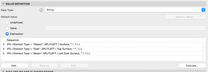

Hi all,
Question for the community regarding expressions in the property manager.
(1) I'm trying to define two criteria (using IFS and AND) to create an output for our finish schedule. If an element is classified in a certain branch AND it's a certain element type, it should output another property we created "FFE FINISH | SURFACE - SLAB [TOP]", see attached for the two methods I've tried and still not successful.
Variations I've also tried:
- Changing "7" to "Slab" - I saw on GDL that the slab element type is given the index 7. I tried inputting without quotation marks, and archicad says that is the wrong data type for the argument, it must be a string.
- I've tried outputting a built-in slab property rather than our custom property - still doesn't work.

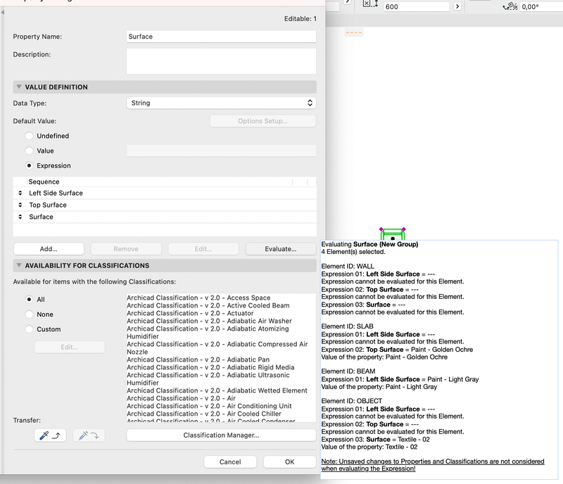

Sequences are evaluated from top to bottom. If the property is not available for the element being evaluated, Archicad moves to the next sequence. If the property is available, the execution of the sequences stop there and the rest of sequences are ignored.
So you need to organize the order of the sequences so that the most specific one (in this case the Left Side Surface property of the beam) is on the top and the most generic one (Surface) is on the bottom.
You don't necessarily need IFS statements if the property is not available for other items.
In the screenshot below I have four elements selected, a wall, slab, object and a beam.

Thank you both for the responses. My direction has shifted slightly since the original post.... the overall goal is to make a label populate with the surface name depending on what type of element is being labeled. I've also named the surface strategically, so I'm using a delimiter ":" to separate the shorthand vs. description, and I'm populating the label with the shorthand. Here's what I've tried (and the properties are available for all relevant classifications).
When I use this property in the label, however, the element type condition seems irrelevant as the label just populates with the "Surface" property - the property listed in the first line. If I switch the order of these conditions, then whichever output property is on top is what displays. I've also tried to put all conditions in the same "IFS" statement, but that doesn't seem to be working either. I should also mention I don't want to use classifications as a search method because that would involve creating additional unnecessary classifications and assigning those to various elements in order for them to label correctly, when really I just want to utilize the element type as the search criteria (without creating extra steps, if that makes sense).
... correction on that last post - the IFS statements work for all element types EXCEPT beams and stairs. Can't get either of those to work.
Solution
