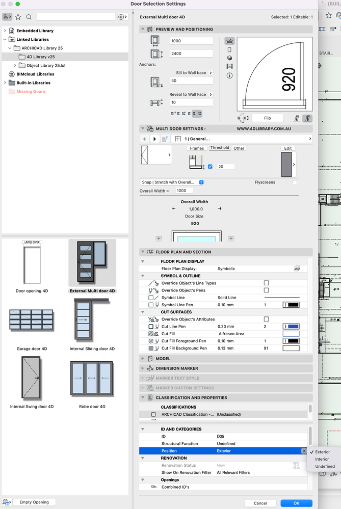

Hi there,
Is there a way to edit the items available in the drop down list for an elements "Position"?
For example: Door Selection Settings > Classification and Properties > ID and Categories > Position
The available options are: Exterior, Interior or Undefined.
Can this list be edited? If so, where?
I have had no luck reading through Archicad help or forums.
Thank you,
Sharyn
2 Replies 2
No.
The Structural Function and Position values are hard coded in the software.
They are not user definable.
