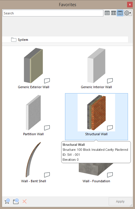

In ARCHICAD 20, Favorites get a fresh look and feel, right in line with the new user interface. In addition, Favorites are now much easier to use, which makes their power accessible to beginner and expert users alike. The fundamental behavior of Favorites has not changed. Here are some known issues or limitations regarding Favorites:
    • Favorite previews are generic: they do not reflect all tool settings. E.g. the preview will not reflect the element height; the preview is used more to indicate element typology. For example, the preview will show structure and hatching. The default size is 1 by 1 m.
    • They are scaled to 1:50: that is, they are not based on the floor plan scale.
    • Favorite previews cannot be customized. This is because they are not stored anywhere; they are generated instantly.
    • Previews are based partly on hard-coded settings, and partly on variable settings. (For example, a change in pen set is reflected in the preview, but changing to a Core Only structure will not affect the preview.)
    • The wall orientation is always shown with its outside on the right.
    • The info tag, which appears when you hover over the previews, is not customizable either.

You can switch instantly between 3D and 2D views of the Favorites: press Shift and hover your mouse over them.
