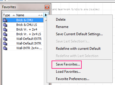

I am trying to transfer favorites from AC12 to AC13 - just took 13 out of box - anybody know easy way???
Go to your favorites.
Look for the little right pointing arrow at the top.
There's an option for saving.
i know this part - but when i loaded it on AC 13 everything was there but it was grayed out and not accessible - i figure the library make-up (GDL stuff I guess) of each object changed from 12 to 13 and may lead to this problem of transferring. but is there a way to do this so you don't have to re-create a whole list of favorites'? if not , there should be
I would guess that you need to load the ArchiCAD 12 Migration Library as all the library part favorites would refer to the old AC12 objects.
The Migration Library is found in the standard ArchiCAD 13 folder - just load it using the library manager.
