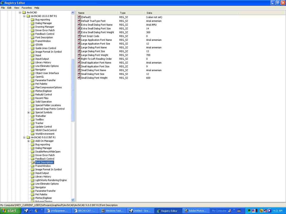

I am an ArchiCAD user since v4.5.Starting from v7.0 I used to change all
font name in registry font description from arial to arial armenian,and font
script code from 204 to 0,and everything was OK.I could work in AC placing layer names,story names,detail and section names and etc in
armenian,until version 10.
Now I try the same ,but it functions partially.The old insertions are displayed in armenian,but I can,t insert new ones.Can you help me please?
It is very important.

While opening the same in AC-10 everything was OK,untill I edited the
layer name,the story name and the section name.
