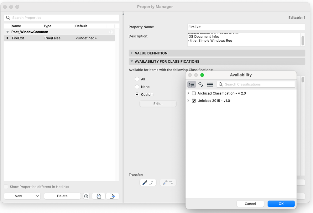

  • Go to Options/Properties and notice that these have been collapsed to make it easier to identify the properties that the IDS file will generate at the end of the list of existing properties.
  1. Go to the File/Interoperability/IDS menu and select the Import IDS command. Select IDS-EXAMPLE GS.ids file already provided.
  • Look at the dialog. At the top of the dialog (IDS File Details) you will find a description of the author, tool, and general notes on the purpose and phase for which the specification was created. Note in the Properties dialog that Psets_ will be created for walls, doors, windows, and slabs.

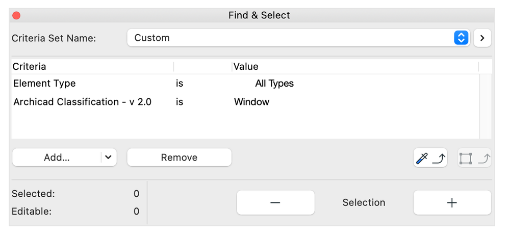

  1. Once the file is imported, you must re-classify the model elements according to the following table, using the Find function (Ctrl+F or Cmd+F) using the AC classification as the criterion:
Archicad Classification - v 2.0
IDS Classification
Drywalls
Ss_25_20
Structural Walls
Ss_25_11
Doors
EF_25_30_20
Windows
EF_25_30_97
