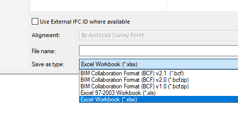

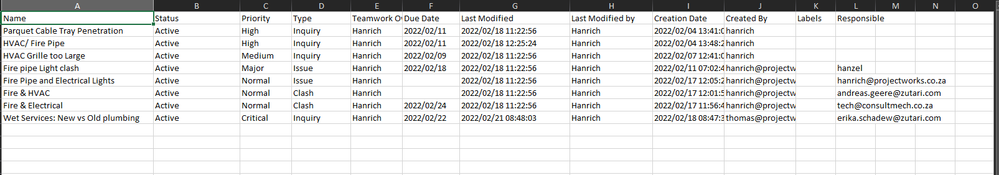

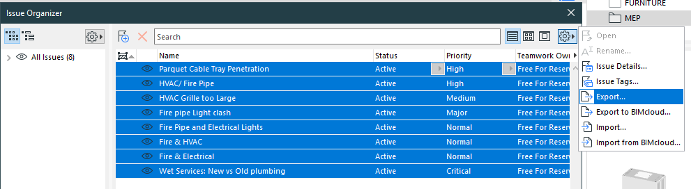

When exporting MS Excel spreadsheet reports from the Issue Organizer in Archicad,
only the headings in the issue organizer are exported.

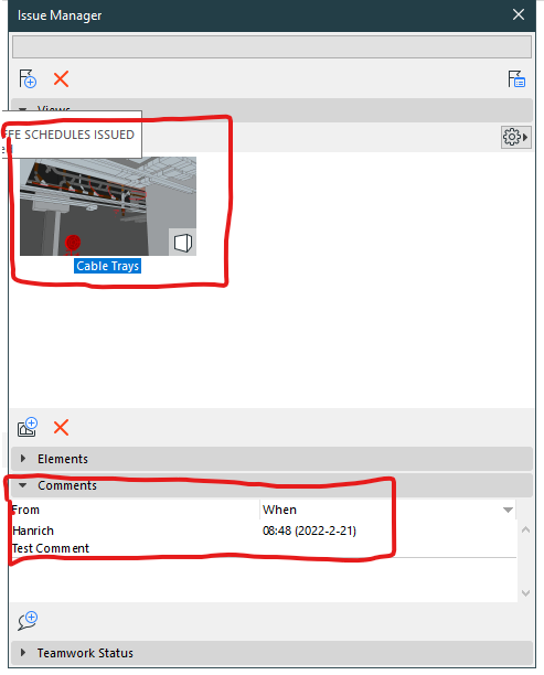

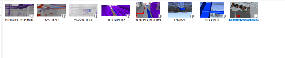

Data such as comments and marked up views of the individual issues
are not exported.
I would also like to submit this as a wish for future Archicad versions.
