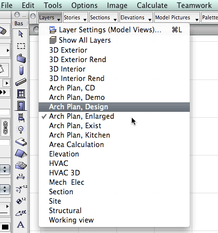

is there a toolbar or palette that i can leave open floating or attached to the side of AC where my layer combinations are in it for fast toggling..
im getting sick of ctrl L - choose combo - hit ok just to check something then do it all over again to go back to where i was. i know it dosnt take long, but i go back and forth alot to cross check things.

Try Quick options

The advantage to the quick options pallet is the ability to change settings as to the view using any combination ,scale,structure, pen set etc from any window or layout There is also various layer icons for the toolbar

It is also possible to create a custom Toolbar with many different selections and/or windows available directly.

perfect.. thank you
