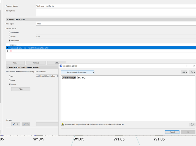

I am simply trying to do the following but Im not getting something about the flow of datatypes and its certainly not obvious or friendly from my perspective but maybe its the siltation from listings
1. I choose area datatype and do a basic if statement to extract gross site area from a zone
Error!

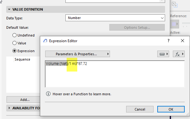

So what about the other way around?
Im trying to create a number but part of the expression is volume...why is this error happening...do I have to cast it somehow?

If you want the output to be a number, then you have to convert your volume to a number by dividing it by 1m³.

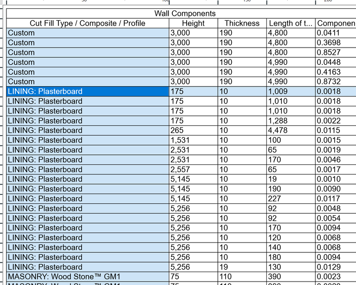

Back to gdl...except it looks like you can interrogate sub components of a complex wall in the schedules...but only front and rear...or components but seems no way in GDL???
Has anyone actually used of this for serious scheduling
eg Masonry is calculated on volume
I need to interrogate every element that contains a particular masonry building element volume
Then do the calcs to get unit numbers...
EDIT: On top of that, if the wall is a custom complex profile, then there is no name for the sub components...why?

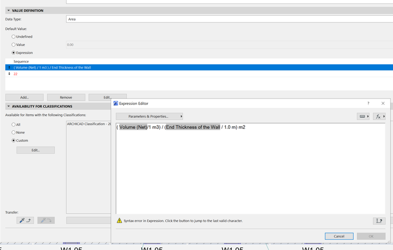

Im actually just trying to get the surface area of a sub component in complex wall but looks like its not going to be simple...of course Im missing something but like I said...why is it not refined?
So in this case below, why would it still be in error?
and based on the logic of the example provided, here ie target = area, therefore I need to divide by 1m3 (as unit) and then convert that to m2 for target format?

poco2013
Mentor
I believe your missing a multiplication sign between your cal and 1 m
