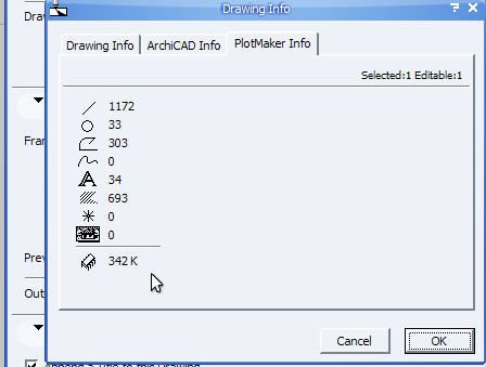

I can't seem to find this; Is there any way to easily display the size of imported files in plotmaker? Navigator shows general info but not size, unless I'm missing something. This is in response to the 'Not enough memory to complete the operation' message.

If you bring up the dawing settings(right-click on the drawing in the navigator and click on drawing settings), and click on the 'Additional Info button' you get a bit of info about the size of the drawing.

Yes/thanks, that info is helpful (exactly what we needed ), but a bit circuitous to get to.
Tom,
We're putting together a portfolio in PM with lots of images. At a certain point we must have exceeded some limit getting the 'crock' message. We're trying to identify/modify the largest files hoping to eliminate the 'memory message' issue. Having the files sizes displayed in Navigator would be somewhat helpful in this instance.
