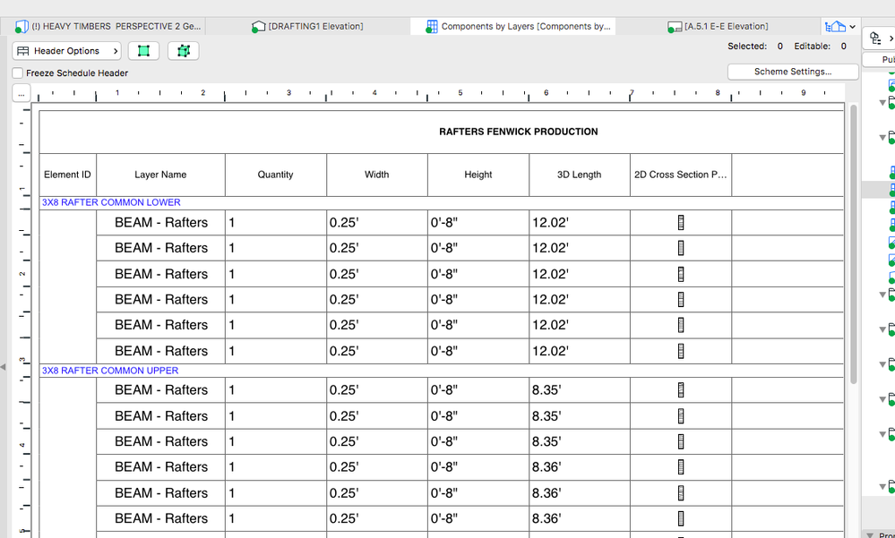

seem to be stuck with "decimal feet" in this schedule. Have tried to change in global project preferences, but it doesn't change in this schedule of components by layers? Seem to remember coming across this before, but can't recall the solution, if any. Any suggestions welcome!

I think the units are controlled by the Project Preferences > Calculation Units and Rules, so there is no Feet & Inch option, just decimal feet or decimal inches.

thanks for your reply David, ...maybe i should put up a "wish" for those of us in the land of feet and inches.

You should search for an existing "wish", this issue has come up before so someone may have created this "wish" previously. In any case, please post a link here for the "wish" so others can vote.
