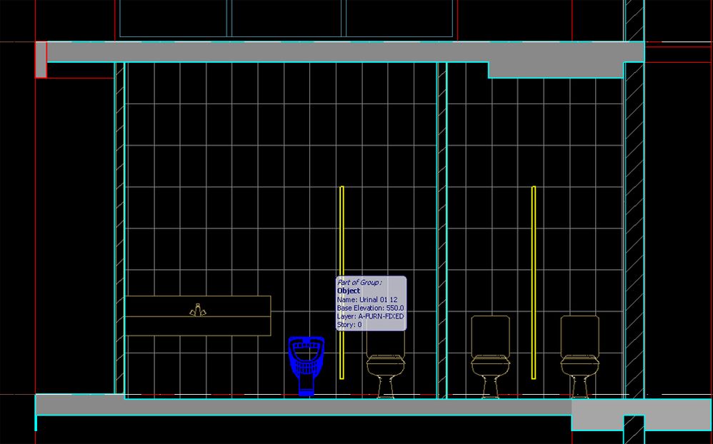

Please see attached.
I'm wondering: can we set start position of the vectorial hatching for the wall? I'm using wall's material, NOT a seperate fill layer. (With Fill, I know how to set the start position)
Please advise
Many thanks
2 REPLIES 2
In the 3D window select your wall and then go to the Design menu > Align 3D Texture.
Thanks Barry,
I've seen it but didn't thought of....
It's done.
Cheers
