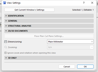

To set the units in the property manager I want to do 500x700. What should I do?
LeeJaeYoung
What should I do?

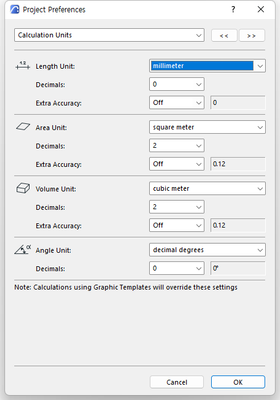

CONCAT ( STRCALCUNIT ( {Property:General Parameters/Width} ), "x", STRCALCUNIT ( {Property:General Parameters/Height} ) )
AC27 on window 11
1 ACCEPTED SOLUTION
Solution
LeeJaeYoung
Autotext label dimension units? - Graphisoft Community
Calculattion units is millimeter
AC27 on window 11
1 REPLY 1
Solution
LeeJaeYoung
