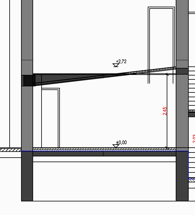

I use ArchiCAD 18. When I use Trace & Reference and change things on ACTIVE story (adjusting facade drawing to section drawing on visible reference) the plan on REFERENCE (so my section drawing) changes to - it is annoying like hell! I mostly use marque tool and than I realise my drawing on reference layer is all distorted because of the changes I did on story above.

Make sure you are using the thin marquee, if you use the thick one it will affect all floors.

Thank you for your answer. I only see one option for my Marquee tool though. Where can I check it?
In the info box of the marquee tool. Click and hold the option marked in red.
Right now I have the thick marquee that will affect all floors in my project.
Perfect, thank you arqrivas! Eureka moment.
