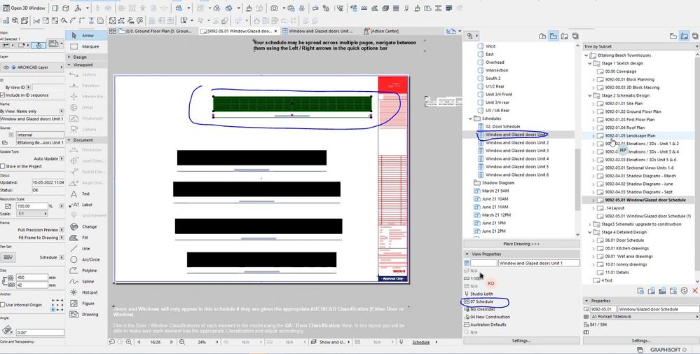

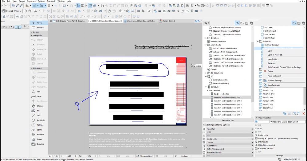

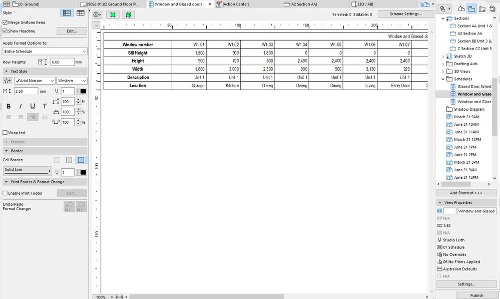

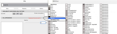

Hello All,
I have created the window schedule in my project as you can see in the image-01 which shows properly and when I drag and drop on the sheet it will show me a black solid fill hatch on it as you see in the image-02. So anyone knows about this how we can show the proper schedule on the sheet?

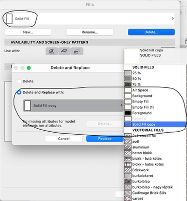

Hello All,
We have got the Solution from the vendor as you see below if anyone will help with future issues.
"This is a known bug registered as DEF-1418 and will be rectified in further version,
For now, you can do a workaround,
1) Go to options > Element Attributes > Fills
2) Duplicate the "last" Solid Fill in the Fill type
3) Delete and Replace the Fill with the new Duplicated Fill that we have created.
4) Just ensure the associated attributes are not affected and you will get the normal results."

User-01
Hello DGSketcher, we tried this but we are not able to get results as you see in the attached image.

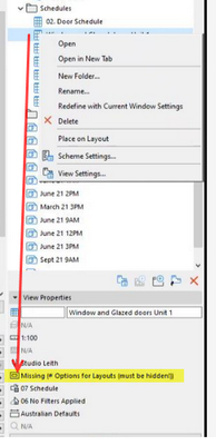

Your schedule view appears to be 'Missing' a Model View Option combination.
I don't think that will make a different if you apply the correct MVO, but probably worth fixing.
User-01
Hello Barry,
Thank you very much for your quick response on this,
We have used the correct MVO but still, it is not appearing correctly as you see in the image.

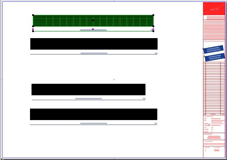

DGSketcher
Legend
@User-01 in the quick setting bar at the bottom of the screen your pens are set to custom. Try changing this to a named pen set. Layouts are supposed to have a single global setting but there seems to be a bug that allows individual pages to store unexpected & custom settings.
You could also try temporarily assigning the standard pen sets to the view and check the pen set assigned in the Drawing Settings in case their is a pen mapping problem with your “Studio Leith” pen set.
User-01
Hello DGSketcher,
We have tried that too but not getting the proper appearance of the schedule is still the same issue.

User-01
Hello All,
