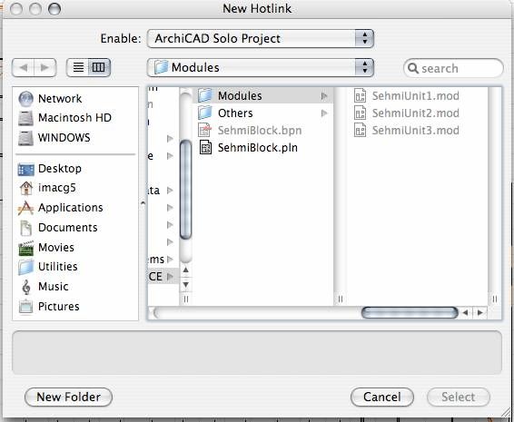

How do I open a module file in a new window? I have created the file and saved as a module file. But when I check hotlinked modules, there are no hotlinks to any files.
1 Reply 1
TomWaltz
Your "enable" setting at the top of the screen is set to "Archicad Solo Project", so the menu only allows PLN files to be opened. Click it and change it to Module Files or All Archicad files and it will work.
