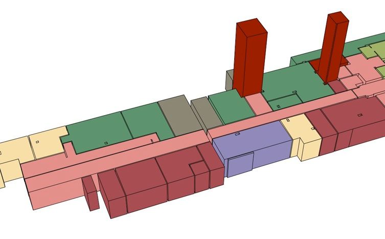

Okay I just figured out a sort of work around for anyone having the same issue.
You have to go into the tool settings (Zone Selection Settings) and set the model paintbrush drop down to the same color that you used for the 2D version of the zone. (The problem is that the colors that you used for your zones don't exist in the materials palette...)
You have to set up all of these colors in your material palette through Options/Element Attributes/Materials. Select any material and hit duplicate and then rename it. I just created "materials" called Zone 1-9 that are identical to the ones I used for the 2D Zones.
You have to switch back and forth a lot .
Testing
The 3D image above is exactly what I wanted, but I wanted a more polished view so I did a photo render projection - but for some reason I lose all of the color settings and I can't figure out how to get them back. Does anyone know how to get the color to come through in the Photo Render projection?
Eric Bobrow rescued me. Thank you Eric!
If you are using Lightworks to render, you have to go into each of the materials that you created (Options/Element Attributes/Materials) and select each material individually. With "Lightworks Rendering" selected in the drop down, click the "Match with Internal Engine" button at the bottom of the window.

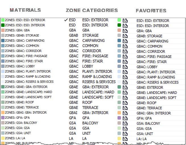

IME that is the best practice to get around this 'limitation'. In our company template I've mapped all materials, zone categories, layers, etc, and assigned them to individual zone favorites.
They look great in colored masterplans and in 3D presentations (our presentation department chose the colors!:wink:).
Plus, they're very intuitive and consistent.
Cheers,
Link.
