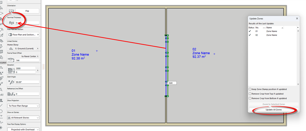

Zone boundary excludes curtainwall footprint area.
Normally not an issue when curtainwall is used at exterior walls but it is when used at interior room boundary walls. The curtainwall footprint areas get excluded from the zone boundary/area. The excluded footprint seems to be fixed to the curtainwall's default size and offset location; it won't update when you change the offset distance or the frame sizes. Is there a way to include this ignored footprint area?

Have you tried yourself? That relation to zone setting doesn't matter. That's for the curtainwall to be either used as zone boundary or not and how it's included in the area calc. You set the curtainwall as zone boundary but the boundary itself is excluding the cw footprint area and there seems no way to extend the boundary to include the missing area.
Set the CW as boundary, zone construction method to be reference line based and set the zone polygon as Gross, and see what happens.

The curtain wall is set as a zone boundary so you maintain the two separate areas.
(you could also place a line to act as a zone boundary and set the curtain wall to not have any affect on the zone).
I found if I adjust the nominal thickness of the curtain wall and then update the zones, it has an effect on the zone areas.
Zero nominal thickness seems to be allowed.
As I said I rarely use curtain wall, so unsure what affect this has on them - they seem to be the same in 3D.

I tried it myself and set the Nominal Thickness to 0. It actually still leaves 1mm gap. It never get to 0. You can see the gap if you zoom into the curtainwall while both zones being selected. That's probably the reason why your 01 and 02 zones display slightly different sq m. So 0 is a misrepresented parameter value in the curtainwall settings.
1mm might be negligible for many but I'm not that comfortable as the building code and the plan examiners in our region are very particular about the floor area calcs. They check the numbers to the millimeters. But nonetheless, this is much better than having to deal with 150mm gap.

Yes there does seem to be a minimum 1mm gap, even though it say zero.
Interestingly you can type 0.1 for the gap and it will reduce, and the area will be more accurate.
If you have your 'Working Drawing' accuracy set to one decimal place, you will see "0.1" otherwise you will only se "0" even though you type 0.1 and it uses 0.1
Typing 0.01 seems to force the boundary to be ignored and the two zones will show the combined area for both.
