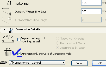

1.Options >Element Attributes > Composites > Brick plastered both sides
2.
3.Walls selection settings
4.Dimension default settings.

Actually, Beart, while your method will will work - that checkbox cannot be memorized with a view. Thus, it is not possible to automatically have certain views (drawings) appear with the veneer and others without in a normal publishing workflow.
Laura's answer is the current best practice: using cutom pen sets, in which one pen set displays the veneers and another attempts to hide them which white pens/fills. These pen sets are memorized with views.
