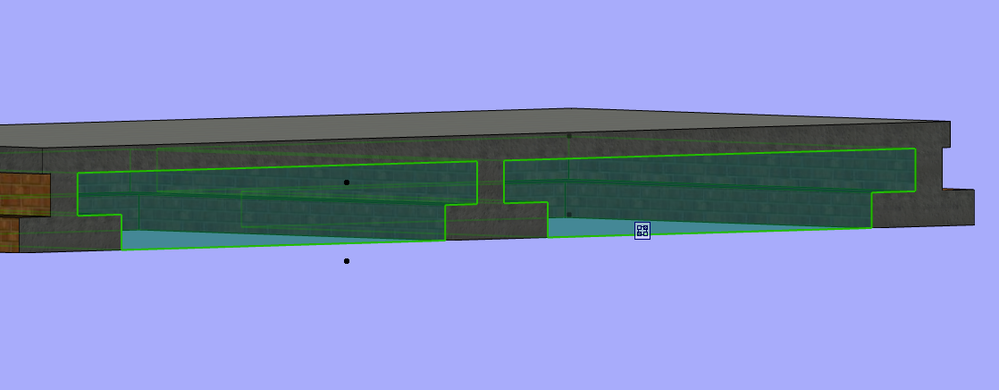

I assume your definition of "Cavity" is the subfloor right?
If you have complex boundary like inverted T shape footings, then place a zone prism and use Solid element operation to cut the structures.

Plus, the screen u posted, is it a zone? how can u show both zones and construction elements? if i marquee an area the zone is not visible.

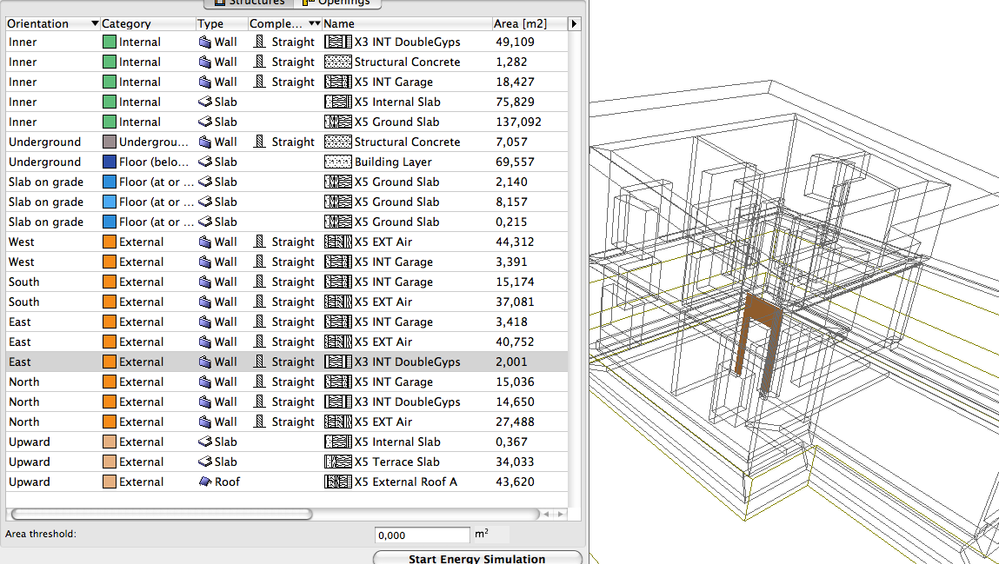

EDIT 2: i have another question. some internal walls are defined as "external" in the structures panel when they actually are internal. how do i solve? Plus, the same element is considered both as internal and external, north and south facing!
Check the Filter and Cut Elements in 3D dialog box, the default setting has the Zone off.
Ok, it works, but even if the set material is glass blue, in 3D it appears as a solid dark opaque volume. Does it have to do with the zone typology? (e.g. gross area, residential, etc)
Look at the 3D Window Settings > Transparency in Shading for either Internal Engine or OpenGL.

Edit 2. As long as your wall's reference side and non reference side are touching(connected) with the zone block, It will recognise it as an internal wall. zoom close into the wall see if it does.
