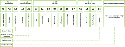

Hi Illes, There are nice-to-haves, ie. methods of compliance with proprietary standards like BREEEAM, LEED, PHI, etc. and then there are our regulatory obligations. Many EU based countries now have aggressive EN standards like Denmarks BR18 or Sweden's BBR18 that mashup Embodied Carbon and Operational Carbon. We believe the focus should soon shift to supporting these regulatory requirements through alignment with ISO/EN standards like ISO EN 15804: Scoped emissions per below.
We can do limited predictive modelling with Energy Evaluation and we can also do LCA for LOD100-300 right inside ArchiCad using schedules and the 'MaterialCatalog.xml' file inside the add-ons for Energy Evaluation - but this limits us to the A1-A3 scope - we desperately need this expanded to the full scope shown above. DesignLCA.com is an alternative for BR18 compliance that we are also using in a North American context for standards and codes compliance, and AHJs (Authourities Having Jurisdiction) have accepted our submissions by dint of ASHRAE 140 compliance of EcoDesignerSTAR/Energy Evaluation.  That said, we would prefer not to use properties and classifications for this work as these values do not import easily from project to project, where updating an xml file updates ALL of our projects! This is where we feel ArchiCad could instantly and easily increase its value to customers, and not require us to pay yet another subscription to yet another software company. For a sample schedule we use to generate LCA reports on our layouts - this schedule file can be imported to any ArchiCad file. (attached)
