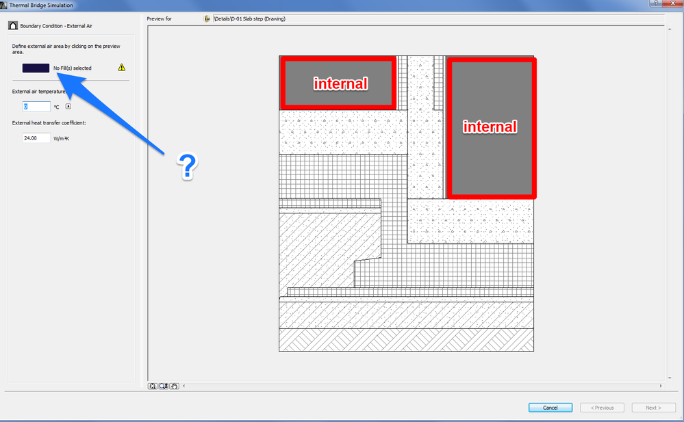

Back with another Ecodesigner thermal bridge question. Is it possible to exam the centre of a floor slab? There is no external air at this point but the first stage demands this is designated before allowing me to proceed.
Do I have to attempt one for the whole slab?

I think the attached image shows a situation where the slab is on soil, which is mostly colder than the interior temperatures. So there is some heat loss in that direction which needs to be taken into consideration.
The above simulation seems to be able to handle with above ground condition. This is why you have to specify the external air. Unfortunately I am not familiar with it enough to say if it can do below ground as well.

Ground in this tool is working quite funny way. It is just a material and not considering the constant temperature below freezing level. I would gladly discuss the calculation method with Graphisoft energy efficiency engineers. (if they have one)
Rob, just take a bigger part of building to make this simulation. Our Estonian engineers have a rule to take piece of ground 20 m apart from building and in depth. Temperature constant is +7oC, building floor at least 4m from wall into the building, 3x width of wall height. This is our local rule to define PSI value of wall-floor-foundation thermal bridge.
I asked the guys at GRAPHISOFT about this.
I was told that you could simply specify the soil fill as "External Air" and specify the temperature of the soil for it. The results should still be correct this way.
Then, in the next Dialog, you would not define a "Soil".
This is a workaround but it will achieve what you are trying to do.

This is not workaround. This is the only proper way. The "Soil" environment is not a working tool at all. It is not working as it should do. Currently it works as a simple material, but is not analyzed during the calculation.
Also, there is no point (in the current edition) to define the temperature at all. unless you are interested in the temperature inside the construction. Anyway L2D value (for some reason called PSI in EcoDesigner) has units W/mK. So there must be just the temperature difference, no matter how big. Inportant are the surface resistances.
