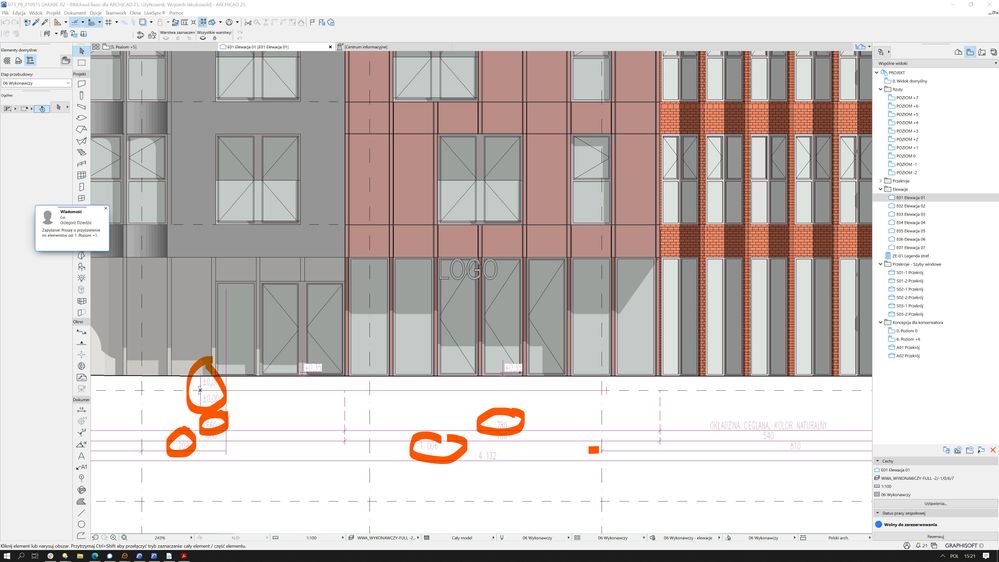

After Receiving operations, dimensions may disappear or appear incorrectly for some users.
  • Associative and Static Dimensions may disappear.
  • Dimensions containing both Associative and Static nodes may disappear or appear incorrectly (stretch, break into pieces, etc.).

If dimensions are out of sync with the central project, that is, they do not appear correctly, it is possible that one of these options might help:
  • Undoing a simple change to an Element that has an incorrect dimension.
  • Rebuilding & Regenerating the view (View > Refresh > Rebuild while pressing the Alt key).
