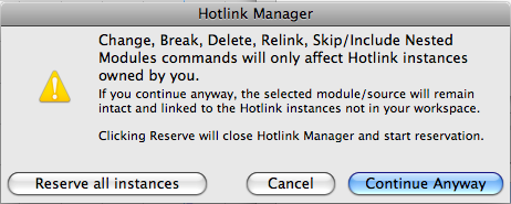

Reserve All Instances of Hotlinked Module
The best way to reserve all instances of a hotlinked module is to use the Hotlink Manager. If you choose an indvidual Hotlink to modify and it is not yet reserved by you the Hotlink Manager will present you with the below dialog. After choosing to reserve all instances you will be dropped out of the hotlink manager dialog. You must reopen it and at this point the individual hotlink you had previously chosen is now reserved. You may now proceed to change it. Choose the source file from the lower half of the Hotlink dialog to modify many hotlinks that originate from the source file. This too will present to you the below dialog. Once you have chosen to reserve all instances you will be droupped out of the hotlink manager dialog. The next time you open the Hotlink manager the source file and all of its links will be reserved.
wp-content_uploads_archicadwiki_teamwork-managehotlink--relinkhotlinkfollowdialog.png
  • If you select "Continue anyway", then only instances that you own will be relinked to the new source. This means that the source will be split in two: Instances reserved by you will be relinked to the new source, instances not in your workspace will still be linked to the original source
  • If you select "Reserve all instances", then reservation will start, which mean that the Hotlink Manager window will be closed, and hotlink instances will be reserved. After this process is finished, then you need to open the Hotlink Manager again, and start relinking again.
