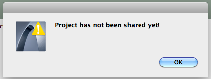

So, i did all what GS suggests to migrate a TW project from 13 to 14, but the process was a disaster.
At the end of the process i got a cryptic "Errors occured while migrating project". Even though the project is present on the Server, when i try to open i get the message "Project has not been shared yet!" (see attached image)
Anyone had similar issue?
At the end i was forced to save the project as PLN v14 and share again.

Unfortunately, if an error occurs on the server during sharing (the migration is actually a clever sharing as well, automatically done by AC in the background) and the process is interrupted the following might happen:
The sharing starts
a new entry is created in the project list to hold the data
-- error occures (whatever it is) --
the entry won't be fileld with data, won't be deleted either
So you can see on the list, but when you try to join the server realizes there is no actual data inside. So it tells you the truth.
Of course migration should work, but even if it makes an error it should not leave the empty project on the server.
