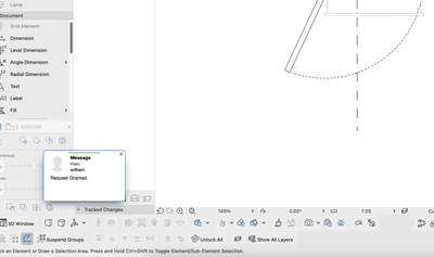

Hi there,
In my teamshare file the notification in the bottom left for requests to edit will never go away even if i grant/delete it. It has been like this for months even though i clear it every session.

Have you tried deleting them from your Messages window inside the teamwork palette?
If you've done so, they shouldn't be appearing the next time you start your teamwork file.

Yes i try this every time and they still just re-appear next session (this also doesn't remove the notification)
