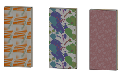

Hi, I'm trying to add Enscape Material Library to walls.
It's wallpaper I was thinking of putting on about a dozen walls.
Wondering if you can add that pattern on walls?
1 Solution
In the surface settings dialogue, you can create new surfaces or you can change the image in an existing surface.
If you create a new surface, you can duplicate an existing one and edit it, or create a new surface from a catalogue.
If you have a SSA/Forward subscription, you can download an 'addition surface catalogue' that has some wallpaper surface in it.

You can't use Enscape materials directly, but you could create your own Archicad surface (material) possibly using images from the Enscape materials.

If you have a picture (image file) of the wallpaper to add to a painting/board (I assume you mean a picture object?), then just create a new surface using the image file.

Options => Element Attributes => Surfaces...
If you look at the bottom of the Surfaces Dialogue you will see that you can just insert any image to use as a basic texture. Easiest way to get something that looks correct is to duplicate an existing surface, then change the image used. If you use any of the other AC render engines, you will need to replicate the image over to the engine specific settings.
Ling.
All you have to do is create the surface material and then apply it yo the wall surface.
You can't use Enscape surfaces (materials) directly, but you may be able to use the image files (texture) from those Enscape materials if you need to.
There are default wallpaper surfaces in Archicad if you want to use those.

Yes, I just tried.
I guess I can add my own pictures too. Trying...
