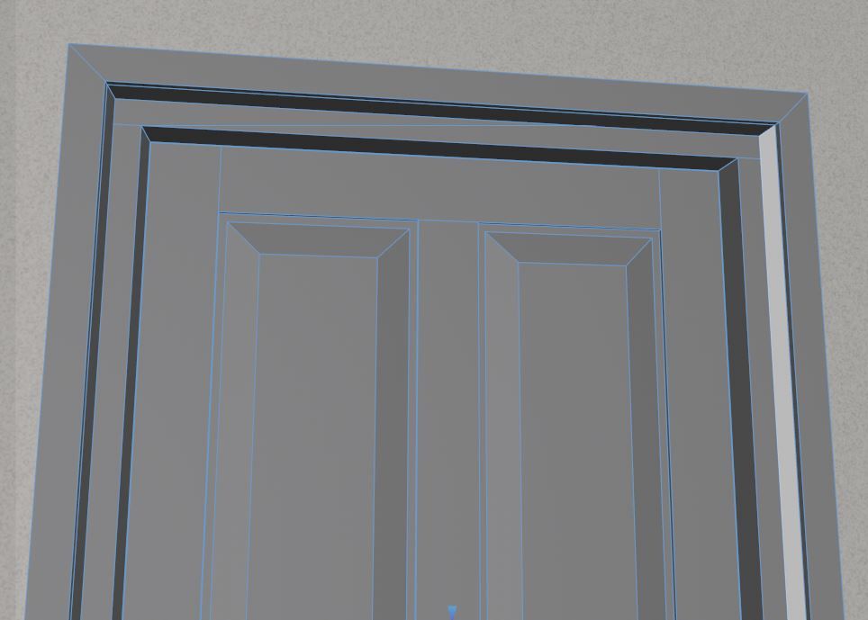

BTW, forgot to tell you, you can also export it by going to the 3d view and save as C4d, I don't know if you will have the same result or not, but you can try to see.
Check the attached pic, the door geometry is quite clean, and this is without doing anything in cinema 4D.
