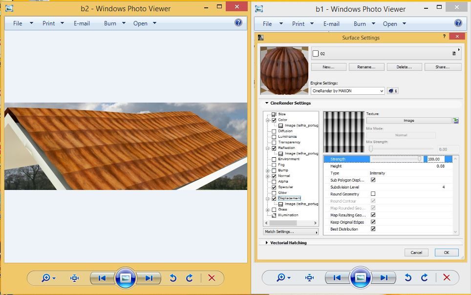

Hi-----
Trying to add some displacement effect to my surface i still find no effect in rendering pic. although it works fine in surface setting window!!! where is my missing point with my thanks
undefined
4 REPLIES 4
The surface material looks OK.

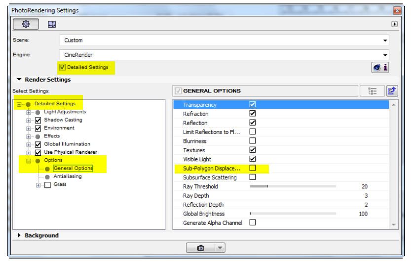

Now you need to turn on 'Sub-polygon displacement' in the render settings dialogue.
I can't remember exactly where (I think 'General' section near the bottom) as I don't have Archicad with me at the moment.
A screen shot from the reference guide.
undefined
You may also need to increase the sub-division level in the surface settings if it looks distorted in the render.
Not too much as it increase render time.
Maybe to 6 or 7?
There is quite a bit of trial and error to pick the right settings.
