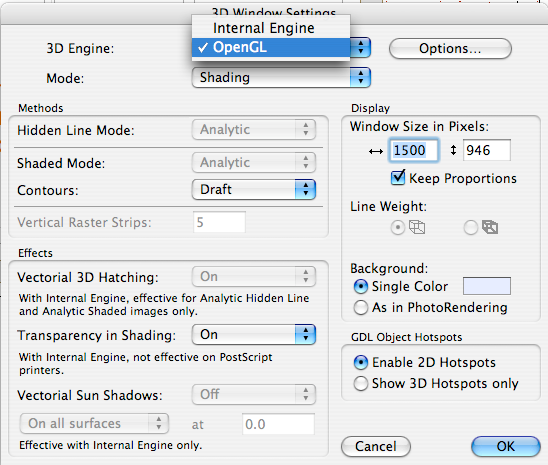

Hello, I have a strange problem with my render. When I make a rend, the render shows all kind of materials , which are assigned to the slabs, with a black color. What can I do? I didn't have this problem before.

Now I see that I don't have an OpenGL in the list of render options.
OpenGL is a 3D window option rather than Render option. Texture images display in OpenGL but not Internal Engine in the 3D window.
I know where it must be, but I don't have it. I'll post a pic what do I have on the 3D window settings menu.
adzik
On your image your in the Photorendering settings window. You should be in the Material editor window instead. Check image...
