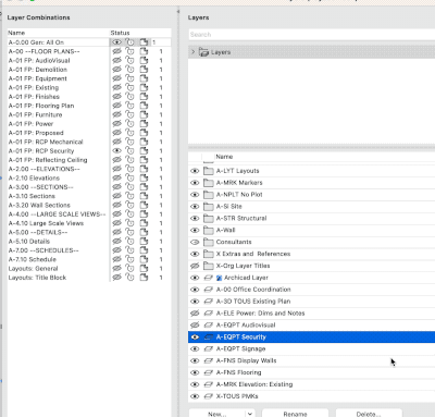

In the Layer Manager, is there a way to move a layer that is nested within a folder to a different folder? The only method I have found is create a new layer in the correct folder, move the content to that new layer, and then delete the old layer.

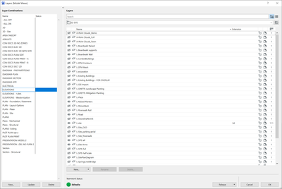

Does this clarify it? 

That is not right. Regular drag and drop should work.
Is you AC up to date?

I believe so, I am on build 26.4022 for Win64.
Where do you drag and drop from? In my Layer Manager panel there doesn't seem to be that functionality. Say I wanted to move one of these layers in the 02 Site folder into a different folder?

Emilio
Yes, thank you very much! The folder menu was completely collapsed on my screen and I didn't realize it was there.
