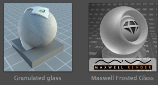

There is a Maxwell engine frosted glass if you have the add-on license. The standard Artlantis shader close to this is called Granulated Glass. I can't remember how to get the diffuse blur as seen in your image...but I remember some guys managed.
