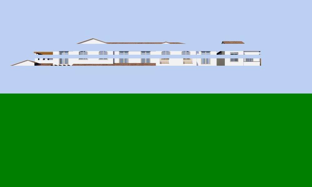

I apologize if this is not the correct forum for this but here goes; I have tried everything I know to fix this problem (see attached banded image) and now need professional help determining if it is the graphics card. We have the latest driver for the card & I've set the hardware acceleration off in both the driver settings as well as Image Settings in AC. We have also messed around with the Virtual Memory settings but nothing seems to work. The model is only 16MB. The banded images do not happen the first rendering attempt after opening AC, but every time after that. The Photo Rendered image is fine every time using the built-in sun, however renders banded with the Sun & Sky objects, even set with low amounts of light sources. Although our card should be good, I will get a new card if required. Any other thoughts are sincerely appreciated as my back is against the wall. Our workaround for this is to restart AC9 each time we want to generate a LW rendering. Restarting AC resets something, who knows what.

Visited our new local Apple Store yesterday. They allowed me to load AC9, then update to the latest build onto a Quad 2.5 GHz PowerPC G5 with 4.5 GB ram. I loaded our 80 unit condo project PLA and attempted to render using LW.
I was prepared to purchase that machine believing it would solve our rendering problems. The identical banding issue however repeatedly occurred as with our dual PC. That leads me to think that for complex models (based on polygon count), LW has a problem functioning within dual processor systems.
I am waiting to hear back from GS for ftp upload instructions for their assessment. In the meantime, I seem to recall that there used to be a way to calculate a model's complexity relating to image creation. Could someone please refresh my memory on how to do this?

Okay. 65 megatron PLA received through FileFront.
There is a problem with the file - as received, I couldn't render it at all. A marquee of the actual building, ignoring the outlying modules and suite layouts solved the problem.
Here's a perspective of the building rendered without banding on a Mac 2x2.0 machine with 3.5 Gigabigs.
Note error report on OpenGL..... whatever that means...

David Tauer of Graphisoft wrote:
From the sounds of your problem it does appear to be memory exhaustion. There are a few things you can do that may get you past the banding and not have a "drastic" change in the render you desire. (I would try them first individually in the order given)
1) change Antialiasing from "Best" to "Better"
2) reduce the size of the render from 17" x 10.19 to something smaller - perhaps cut off an inch or so from the overall size.
3) Change from soft shadows to hard shadows (this is a big memory user)
After looking at the project, I am now 100% convinced it definitely is memory. When you see "Internal error occurred in openGL" that also can indicate that the openGL is having a hard time with memory. That warning also came up. Scott clearly has a large monitor. Those picture sizes are using up memory. A machine with two processors can use up more memory. What happens is LightWorks divides its tasks amongst the processors. Each processor starts using up memory. If the memory is there then no problem, the time is more than halfed. The problem arises when one processor subscribes memory and cannot complete a task due to the memory subscribed by the other processor. That is, the amount of memory used over the period of the render is not significantly different between one processor and two processors machines, but HOW much memory used at one time is. And this could be significant. Which means that a two processor arrangement could exceed addressable memory (virtual and physical) due to the scheduling of subscribing and releasing memory whereas a single processor would not. By the time a single processor system gets to the next task it has already released the memory it needed to complete the task. Hope this helps.

AC9 currently runs under the XP-64 bit OS so I don't see any reason why AC10 would not. That new OS will better utilize the memory - almost 4G instead of 2G limit on Win XP. The Win XP64 OS will utilize almost 4G of RAM.
On a Mac, Archicad can access a little shy of 4GB of memory (physical and virtual). So if the user has more it doesn't matter. On an XP using the 32-bit operating system version Archicad is limited to 2GB.
Here are some suggestions in conserving memory
1) ***** Window size in pixels **** very important
2) **** Window size in pixels ***** in case you forgot number 1
3) OpenGL options Turn off: Highlights, Emissions, Smooth Surfaces, Textures (play around with which ones are important)
4) Contours "draft"
5) Transparency in Shading set to off
Then limit model size, use marquee, use layers, leave out memory hogs like cars and 3d trees and bushes (or put them on layers that you turn on/off in context with a marquee) The Internal Engine was developed when memory was scarce and 256MB was a killer system. It no doubt is more conservative with its memory allocation algorithms, it also doesn't sport all the bells and whistles. The openGL method relies much more on technology supplied by external vendors, and is definitely not as stingy with its memory subscriptions as the Internal engine.
