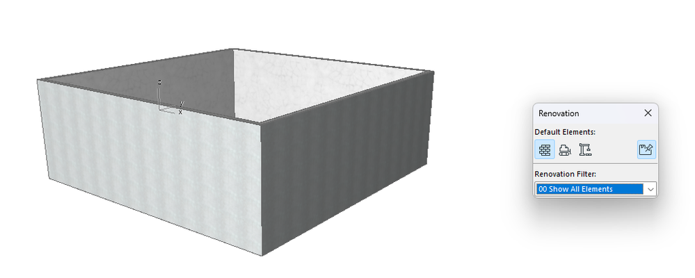

Doors are still showing in 3D window even when the model view option is set to "show opening only".  Is there a setting I'm missing?

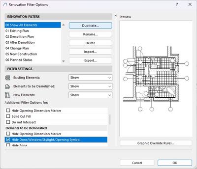

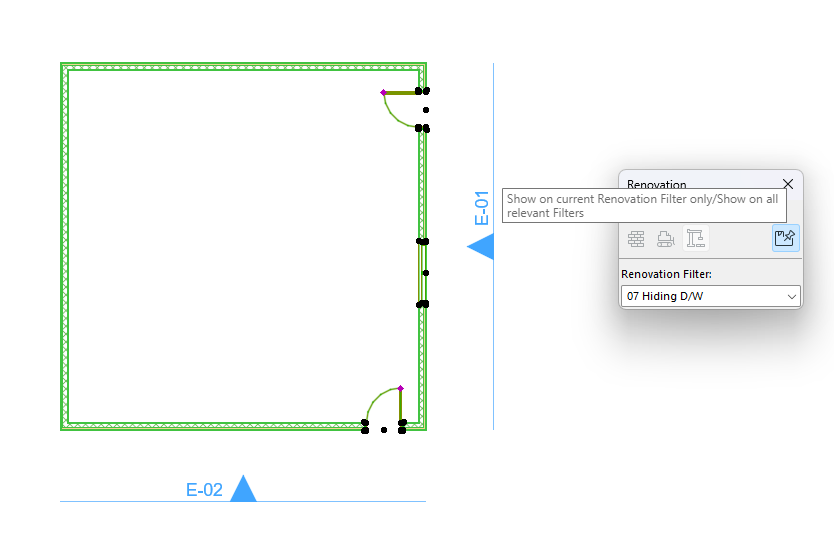

Of course, you can hide D/W in facades & sections using Reno. Filters or Design options with the optional help of Selections, as follows.
_By Reno. Filter:
1) Create a new renovation filter & assign those D/W to be only shown in it.
2) Activate (Show all elements) Reno. filter in your facade or section view.
3) If you like to hide many and distributed D/W you can save them to a new selection for an easy recall.
** Note: It's recommended to perform the a/m steps in floor plan or 3d view, as when I tried them in facade view I had a strange result (seems to be a bug).
*** Here're some illustrating screenshots.
Screenshot 2025-02-26 215140.pngScreenshot 2025-02-26 215200.pngScreenshot 2025-02-26 215305.pngScreenshot 2025-02-26 215314.pngScreenshot 2025-02-26 215217.png
4) To retrieve the normal case only select those D/W and deactivate (Show on current reno. filter only) option.

Dear Mahmoud Qenawi!
I'm afraid you haven't fully understood the essence of the problem.
The problem with this solution is that, the entire door/window disappears along with the wall opening. However, in a masonry plan, the location of the window/door should be visible.
Thank you for trying to help, but this is not a solution to the problem.

Dear @Gabor Szelei,
back to you with another solution & I hope this time it can help.
There’s an ability to show the opening boundary in facade by assigning the wall’s Reno. status to (to be demolished) & activate the option for hiding Doors/Windows.
*#* If the wall’s Reno. status is already adjusted to (existing or new element) you can duplicate that wall/s to a new design option that will keep everything normal in the main model.
