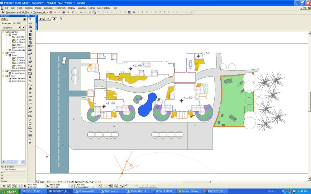

hi im new in archicad and i want to improve my renders
i appreciate any tips or anything else
thank you

Dwight
I have reviewed your file:
1: the textures called by your pictbox treEs did not transfer. This is normal since the PLA file does not archive textures called by objects. No problem for me - just hide the trees.
2: Lose the ArchiCAD background photo - too much magenta and has a bad viewpoint. Use graduated Background in LightWorks instead.
3: Turn off Camera Light. Camera Light Bad.
4: Use SunObject, SkyObject and UnderSunObject instead of the Built-in Sun. Sun Light Sources: 10, Divergence to 45 degrees for soft shadows.
5: Your wall material is shiny. Lose the texture and use Displacement Class - Shader: "Rough" at Parameters: 0.01, 0.01, 1,1, instead.
6: Your water came in as Material C05 - Switch to a textured water.
That's a start.

dwight thanks a lot
my water is an extra texture thats why you cannot see
lights is my problem and your tips are quite useful
thanks a lot i hope in 10 - 20 years to achieve renders better than yours !!! lol 🙂 but still they will be with your advice
