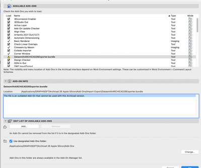

I recently upgraded to AC26, using the latest MAC silicon version ( 26, UKI, 4032, MacArm64, Full)
Unfortunately, I have issues with the direct-link file. After adding the plugin through the add-on manager, the following message appears:
The file is an outdated Add-On that cannot be used with this Archicad version.
Does anybody know what could be the problem? I cannot use Twinmotion with this version currently.

AC has the latest version and the direct link plugin file is the one that is available on the Twinmotion webpage.

The Datasmith link doesn't work with Silicon version of AC26 and the update hasn't been released yet. The forum for Twinmotion suggests it should be available in the next month.
