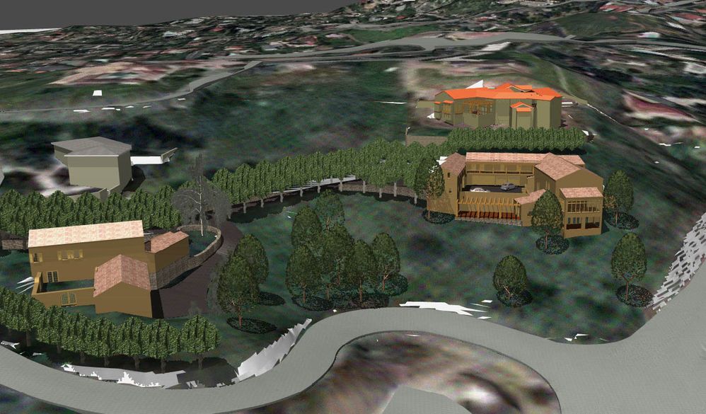

Hello! I tried with a project we already finished and it worked pretty well! I think it must be very useful, specially on more urbanized places. And with better models, as well!
Patricia Leão

I recently saw an example of a building site surrounds modelled with archicad with the google earth image set over the top of the mesh. So what the architect did was lift up the mesh where there were hills and surrounding buildings were lifted also.
This gave a very real looking site context for the archicad building model. I hope to try this approach soon.
I have actually been doing this sort of thing for years by a different method.
First I open Google earth and turn off the terrain then I save high resolution Arial pictures into a folder so that I can tile them together later in Photoshop. Once I finish tiling the images into one large image and crop it I insert it into ArchiCad first as a “Figure”. Then once I have scaled the image to match up with the Topo that I did I can use the dimensions of the figure to scale the material that I make out of the same image. When all is said and done the ArchiCad mesh looks just like Google earth and we can then use it in renderings, fly through, and sun studies.
