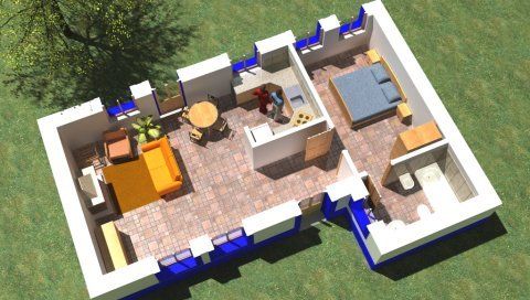

This question begs for another question.
Why would you want an image from your plan?
If you need a technical file, I would recommend PDF output.
If you need a pretty picture, then make a rendering of your model, cutting it at 1.6 meters or whatever.
Use View>Elements in 3D View>3D Cutting Planes.
I recommend you open all doors, this way the image is clearer.
