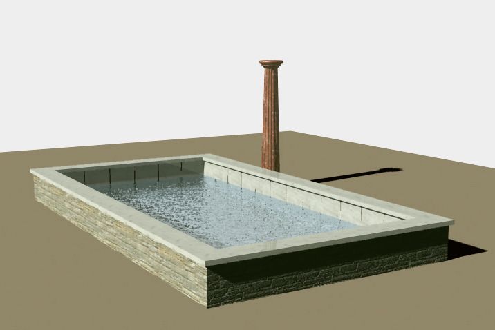

Is there any way i could make a water (this time without the fountain, just water) to look better? A better water texture? Wich one? Or some trick maybe?

any help please. The default pool object from the Libraryand its water texture, are not so real. Any better way of getting the water effect (witout the fountain, just water)?

The easiest way to make water, in any rendering application, is this: make a new material, make it 80-90% transparent, add reflection and add bump. There it is!
Or just apply bump to a glass material!
