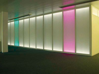

So these diffuse panels are lit with linear light from top and bottom. The likely real-world source is this: http://www.colorkinetics.com/ls/intelliwhite/
best bet : iWprofile g2 - I've used these before altho they are overpriced if you don't need their clarity and brilliance.
We can't really do linear light in Archicad, but we don't want to - we want to use narrow "light cone down" and "light cone up" light sources with wide bases to shine almost parallel light as in this example. You force the disk to merge into the wall, faking the linear look.

heres an example

And i discovered another way to control downlight to make a strip.
Since the light cone is originating from a large disc, it would shine downward out into the space - away from the wall face like we want.
To constrain this light, it would be obvious that a mask would be necessary, but it would be visible in the scene. In my solution, making the mask as a slab with invisible sides and bottom makes it invisible in the rendering - an invisible mask!
It also helps to tilt the light slightly toward the wall.
